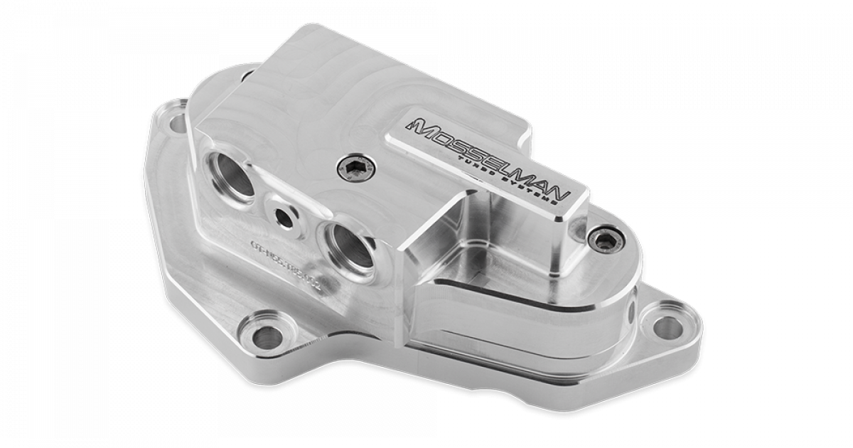

This is hands down the nicest thermostat option for the n54. Integrated 185*F thermostat and threaded for AN.
Judging by that little blueprint of the internals at the bottom of their page it uses the same thermostat design as oem, so it's still going have restrictions.
It is a very nice looking piece and very clean, but it will not hold up to a delete plate + improved racings thermostat in terms of performance.
And they never answer any emails so customer.support is useless.
You can have the best product but is usually let down by their own laziness or arrogance.

After seeing the Mosselman thermostat in person and looking inside the piece, it doesn't appear to have any restrictions that would be smaller than the 10AN hose size. It seems they took the stock design and improved upon it (speculation). Fair point about their customer service though but I haven't had to deal with that yet. Much cleaner install for a double oil cooler (shorter direct lines/less fittings) which is really the main reason I went with it, aside from the fact that it's literally designed for our engines lol.
But keep in mind, if it cools the engine as it's supposed to it isn't any better or worse than the others - it functions the same.
Yeah looking at something online doesn't show the fully picture so it could be alot less restrictive but it won't be as unrestrictive as improved racing.
Also how much it flows to the cooler when its cold? Is can't be only on at or near the trigger point?

Mosselman is a 'neat' compact solution for a standard thermostat with different opening temp. Which could be great for certain applications on mild street car setups. I still prefer the bypass method as superior for oil circulation, temp control and ensuring the thermostat is out of the oil flow path for anything more hard core.
Some questions for them I would be asking are;
* What is the max flow temperature rating when the oil pump is at speed and its fully open? (it will be higher than 185f)
* In terms of flow (easy question) does it flow unrestricted 20GPM ?
Note that all the standard earls and other external offerings in 10AN style do. This helpful to reduce pumping restrictions when you need to move the increased volume and distance of oil over longer lines and single or multiple cooling cores.
