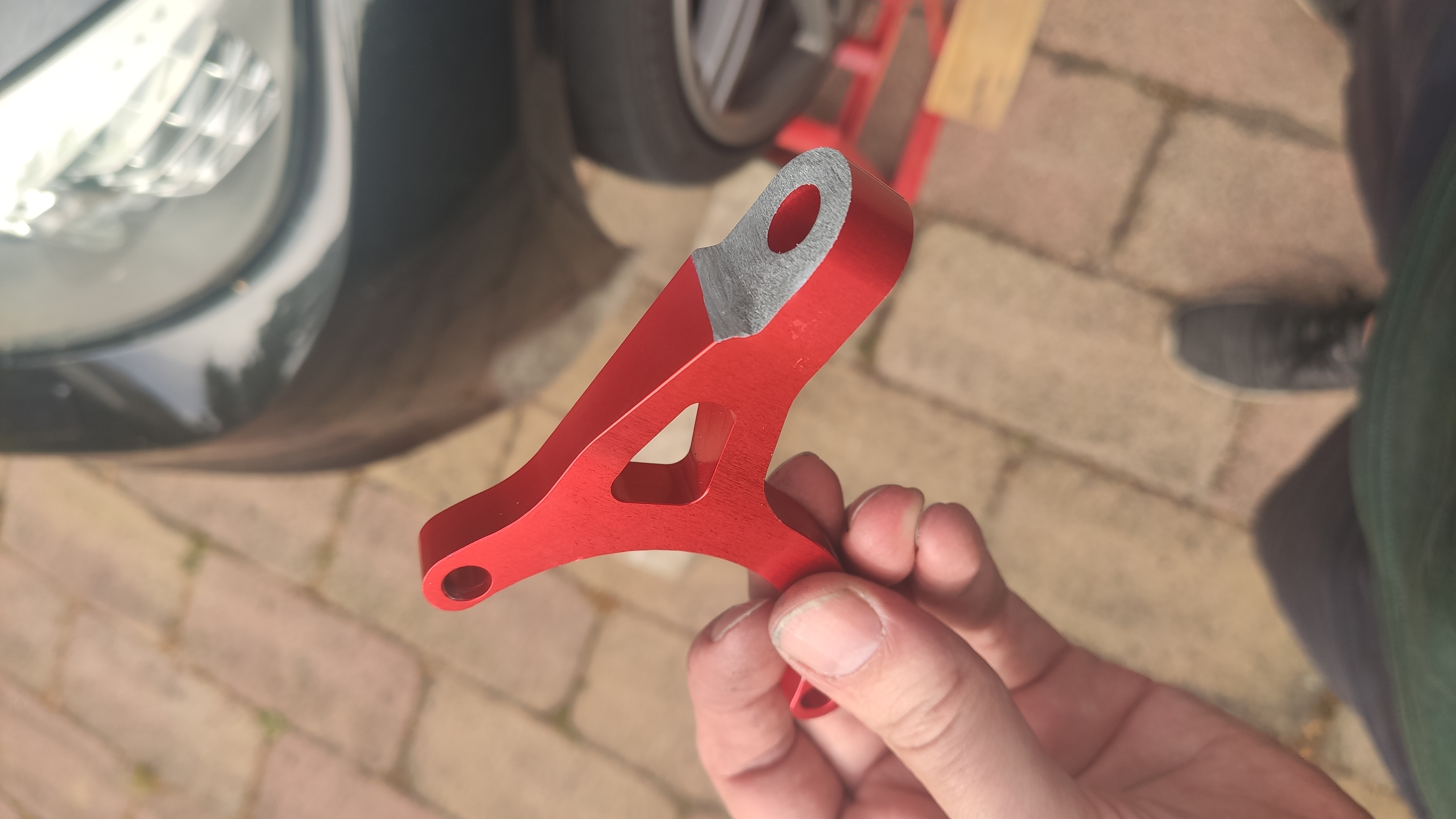

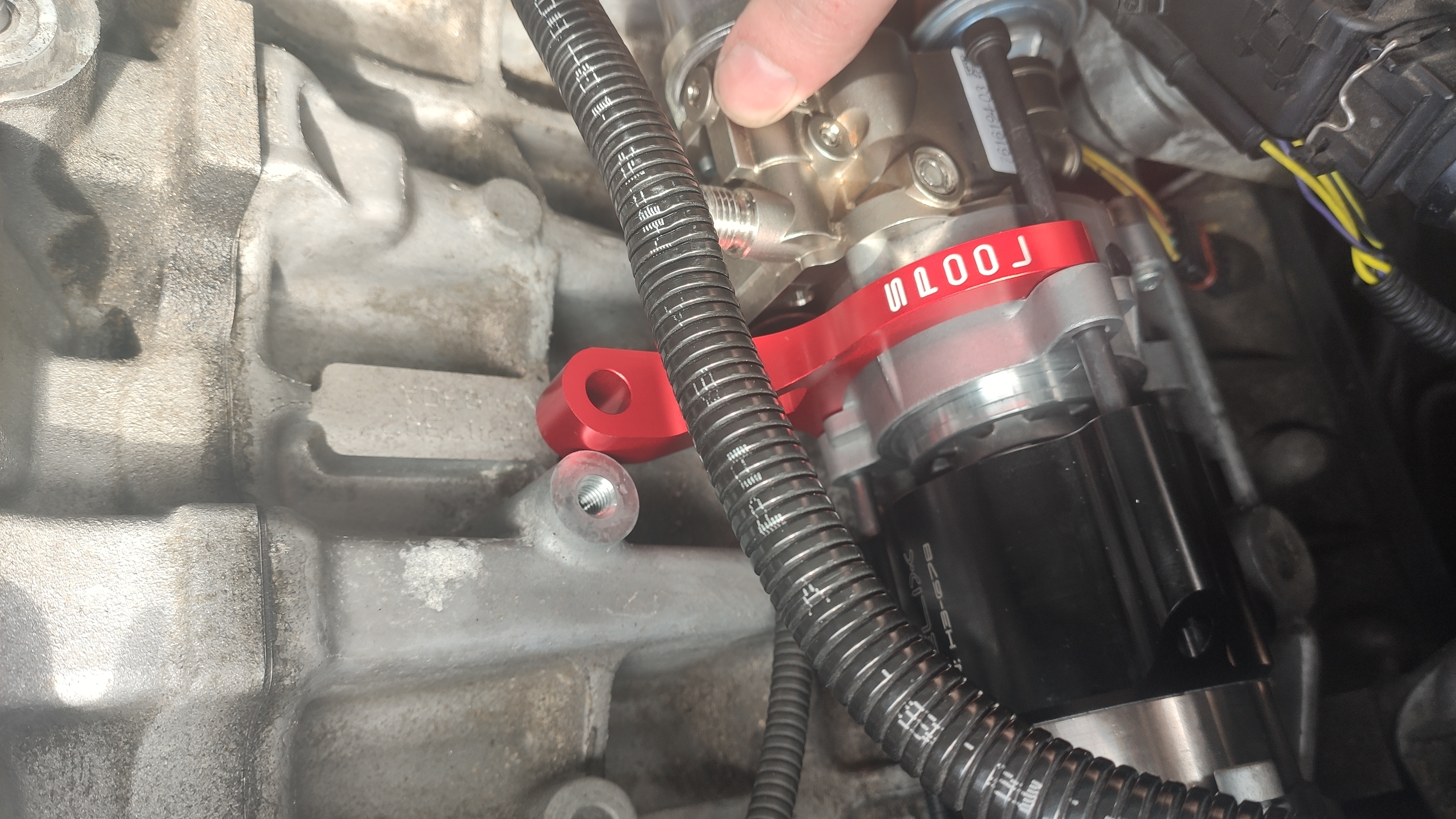

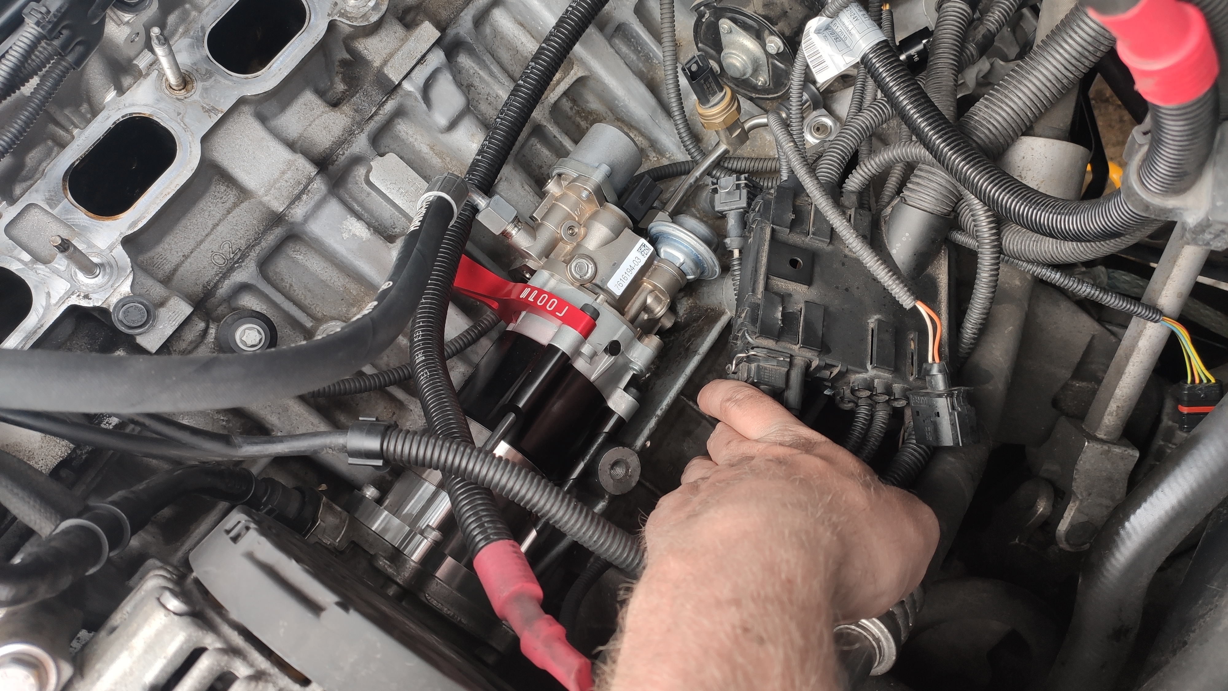

Well call me crazy but the red bracket did not fit on my 2010 E91 LCI.
As you can see on this picture, with the helix and HFPP lined up straight, the bracket won't fit the mount on the block unless you really really force it. That was not acceptable for me.
Since Spool dit not reply to mail or pick up the phone, I took an angle grider and fixed it myself :)
Everything's on decent without any tension. Nice rattle for the first minute on cold start. A tune will fix that.
Reactions: Jern54
3,766
Definitely would not call you crazy, but I'd be concerned with that much variance. At first I was thinking, did you keep all the bolts loose, attach the bracket, and then cinch everything down? But after looking at that grind ...... it's off by a country mile. Why is that?
Slightly concerning tbh, I have just received mine with bracket and filter etc mine is Pre LCI and hope I don't have this issue. It would be nice for @SpoolPerformance to shed some light on this, there service was really good even after it was shipped.
b4llistic
Nov 22, 2018
119
90
BMW N54
I ordered two at the same time, came in the same package. The other one fit perfectly on Jern54 pre-LCI car so i think the problem is limited to LCI cars. Maybe starting at a certain build date. But that all guess work at the moment. We will need more installs on LCI cars to know more. I haven't seen many (if any) of them yet.
Reactions: Benji335i
3,766
I would think a comparison of relevant parts on real oem would give some indication.
