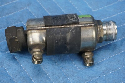

Even BMW have realized heat is an issue.
They went water to air ic's and massive ass grills in the front bar and vented bonnets on the newer models once they started ramping up the hp.
Here we are playing with 6, 7, 800 or more and no one addressing heat issues as most are just dyno one pull queens.
Dodge and Mercedes have realized this and installed fuel chillers, vented bonnets and headlight ram air.
Adding more airflow into our little ovens will benefit more than most will think, whilst most think that having no airflow or limited over the fuel lines
has no benefit are not very well informed or haven't done the testing.

The only issue I see with these will it handle our fuel pressure as we almost run double the pressure of most cars on the lpfp system, forget running this on the hpfp system unless it can hold 3600psi
