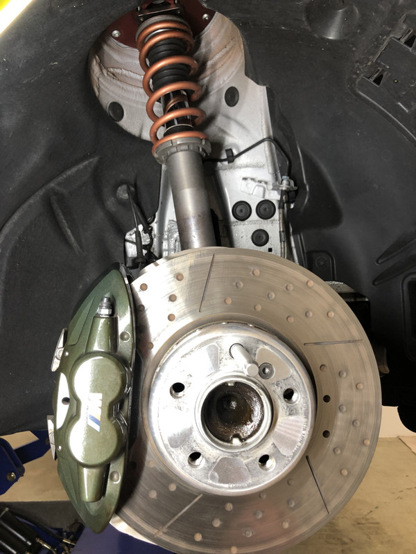

If you are doing this as a cosmetic mod I wouldn’t recommend using them on track.
I turned the calipers browny/green within ten laps first time I used track pads.

That is insane. I hope the Rotora calipers won't do that. I predict they will be much cooler than these you show here because the rotor is floating 2 piece and drilled.
I wonder if they made green m calipers would they have turned blue from the same experience on track....; P
