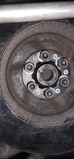

Cleaned and swapped solenoids, sensor and check valve. Still got the same code. Looks like I spun the crank, checked today and 2 of the 6 cbc bolts were finger loose.

So have you got a spline lock or just the cbc ?
Both spline lock and cbc. Had the spline lock installed since November 2018 when I spun the crank the first time on mmp turbos. Now 2 weeks with hydra turbos and it spun again.
I did have the crank hub removed 2 times since then cause I have the stupid helix 3x that failed on me twice causing broken timing and oil pump guide components.
Maybe that's the reason it spun because the repeated removal and install.

Over on f80post some s55 guys loose cbc bolts but their hub hasn't spun. Here's some intersting cbc reading:

You have the v1 spline lock which had issues, the v2 wasn't released till April 2019 if I'm not mistaken.
More then likely the helix is what's caused failure with either your timing gear or vanos hubs.
I still very much doubt you spun the hub but its some other failure, keep us updated.
