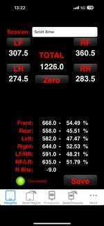

Made it out on the 27th and my stock welded diff broke on the first run unfortunately. I think the hard launches on the glued track weakened it last year as it started leaking oil out the breather hole, me being me I just cleaned it after every run. That went well.
But it's clear my suspension is all wrong. I've went far too soft at the rear and I'm just fighting for traction. Corner weighting showed how far out it was.
Nearly 60kg out over the front left and right without me in it. Although I've finally got the car weighed: 1226kg (2700lbs).
I've since ordered up some custom 2 way adjustable coilovers and will begin a tear down of the rear subframe. Solid bushes going in along adjustable arms etc. Looks like the 27th was my last event of the year šŸ˜‚
