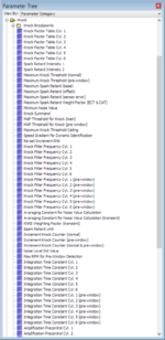

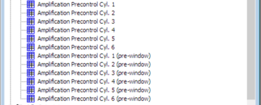

It includes all of these, and the associated 60+ logging params to properly tune the tables.

If you could send or post the xdf, I could do some non dyno experiments shortly. I think some of the noise related tables may help with the annoying high rpm cyl 6 misfires. max rpm for pre-window detection might be useful there also...
I have a built engine with je pistons so there's a good chance I may see some false knock. Can't say for sure yet, since I still have to get the engine back in the car. I was going to last weekend, but I used an 8 bolt crank for the new build and didn't realize the old engine was 6 bolt. New flex plate was delivered a few minutes ago, so I'm good to go again this weekend.
