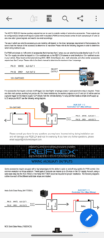

Yes I read in the motiv setup instructions, the 2 aux wires are for low voltage items such as Mac or to turn on meth or nitrous. It cant run the whole pump for meth too much power but it can power the on off switch I believe. I actually have a bms 4 port Mac and I cut the plug off to hook it into the reflex

Do you have a link to those instructions? Or is it just the wiring diagram?
Yes had to take a screenshot or pay for the adobe app
