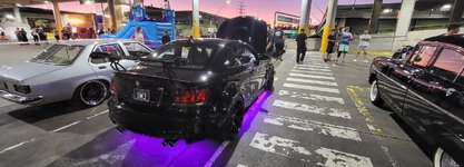

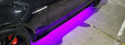

Added some undercar lighting for night time shows a few months back, turned out quite good and got a lot of positive responses thus far.

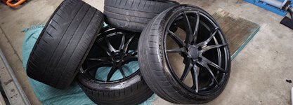

I went out and checked out these wheels for a customer but he didn't want to pay what they were worth so I ended up buying them for myself.
They got a few paint chips and that's about it, worth every penny otherwise.
Here are some wheel weights including tyres in kg, if you want it in lbs use a calculator LOL.
Custom m359 rim/wheel 20x9 +20 255/30/20 Weight 23.6kg
Stock m359 Front Rim/Wheel 19x9 +31 245/35/19 weight 23.6kg
Apex ARC 8 Front Rim/Wheel 18x9.5 +22 245/40/18 weight 20.8kg
Bc Forged RZ 39 Rim/Wheel 19x9 +15 255/35/19 weight 20kg
Koya semi forged SF06 Rim/Wheel 20x9.5 +20 245/30/20 weight 21.1kg
Front weight saving 3.6kg per wheel over stock
Custom m359 rim/wheel 20x10.5 +25 285/30/20 Weight 27.1kg
Stock m359 Rear Rim/Wheel 19x10 +23 265/35/19 weight 24.6kg
Apex ARC 8 Rear Rim/Wheel 18x10.5 +27 275/35/18 weight 22.2kg
Bc Forged RZ39 Rim/Wheel 19x10.5 +25 275/35/19 weight 22.5kg
Koya semi forged SF06 Rim/Wheel 20x11 +27 285/30/20 weight 23.5kg
Rear weight saving 2.1 kg per wheel over stock
Reactions: Neophyte

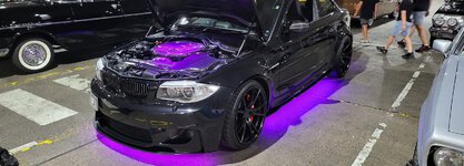

Couple of extra photos from the weekend snapped by some mates, people come up to me all the time just to talk
about the car and the usual crowd gawking all over it, it makes up for all the hard work so people can enjoy it whilst raising money for charity.
At this event you can talk to the cops about your car and how you can fix not so legal issues if any and not get booked for it.
You can have a conversation about future mods your planning and their legality.

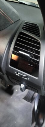

Finally got around to fitting the P3 gauge now to wire up the analog inputs like fuel pressure as protools
fails to read most of the obd2 channels on the s65 ecu.
The raw channels outputs on protools have been coming soon for over 3 years LOL, buggy software anyway and have to go old school analog
to get what I need.
