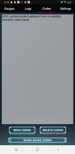

Was driving my car around for a few days no real issues. Put some control arms last night on and went to get it aligned today. After I picked it up from the alignment shop I have this code and cannot clear it bank 1 afr is stuck from around 15.5-16.1 no matter if its coasting or wot. This is why I hate having other people work on my car without me being there. Should I just get some new 02 sensors from fcp and ship the old ones back?

Local parts store sells some. Id just return to fcp and use the local stores who carry in stock, then if theres any issues there's no wait on shipping.

Yeah that's a good point. I'm not sure what the shop did besides alignment but thats all I asked them to do. Bank 1 always read perfect with the new 02s And was reading good before I took it to the shop there such a pain in the ass to deal with id rather get a new 02 toss it in and see if I'm back in business.
