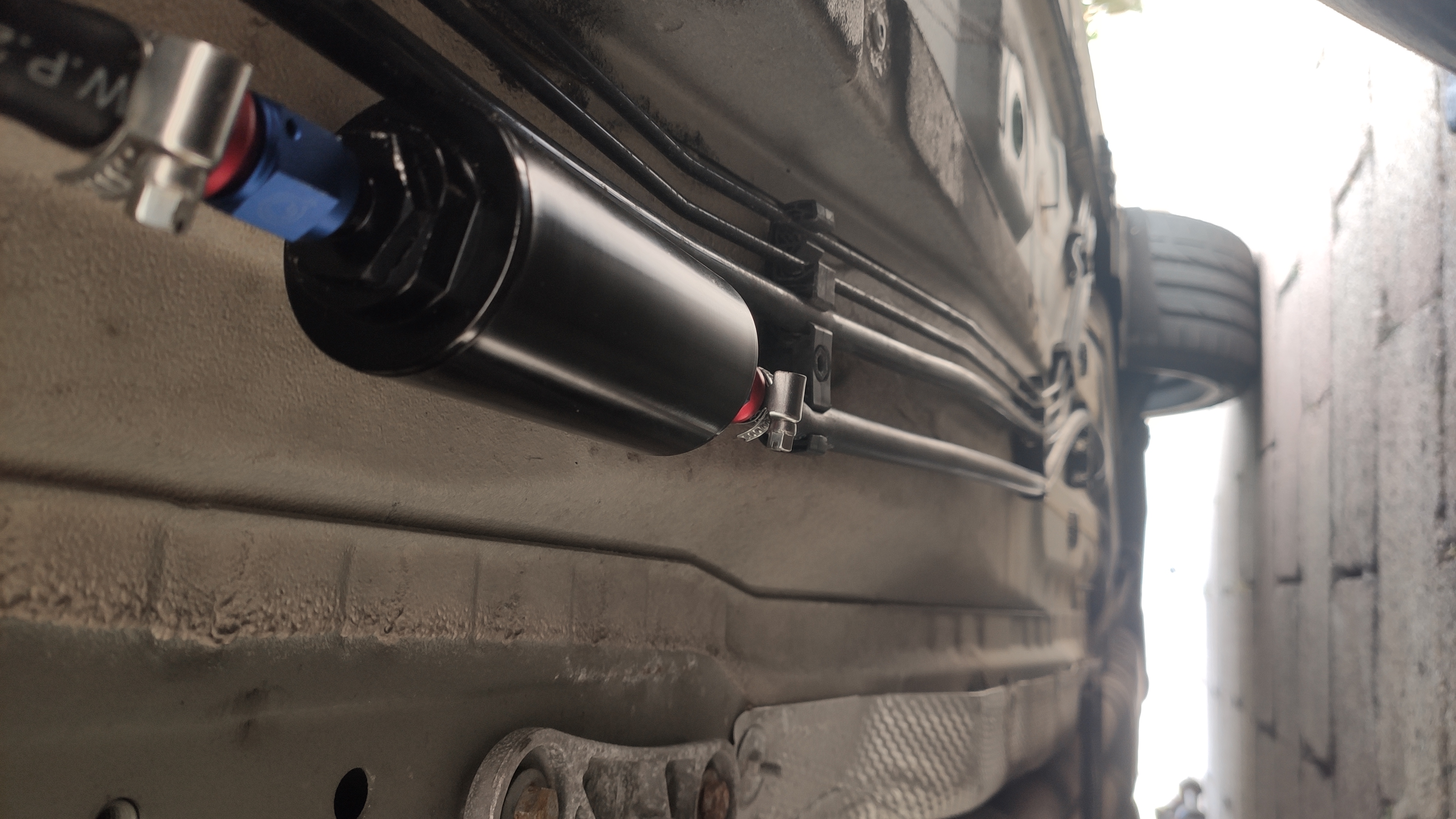

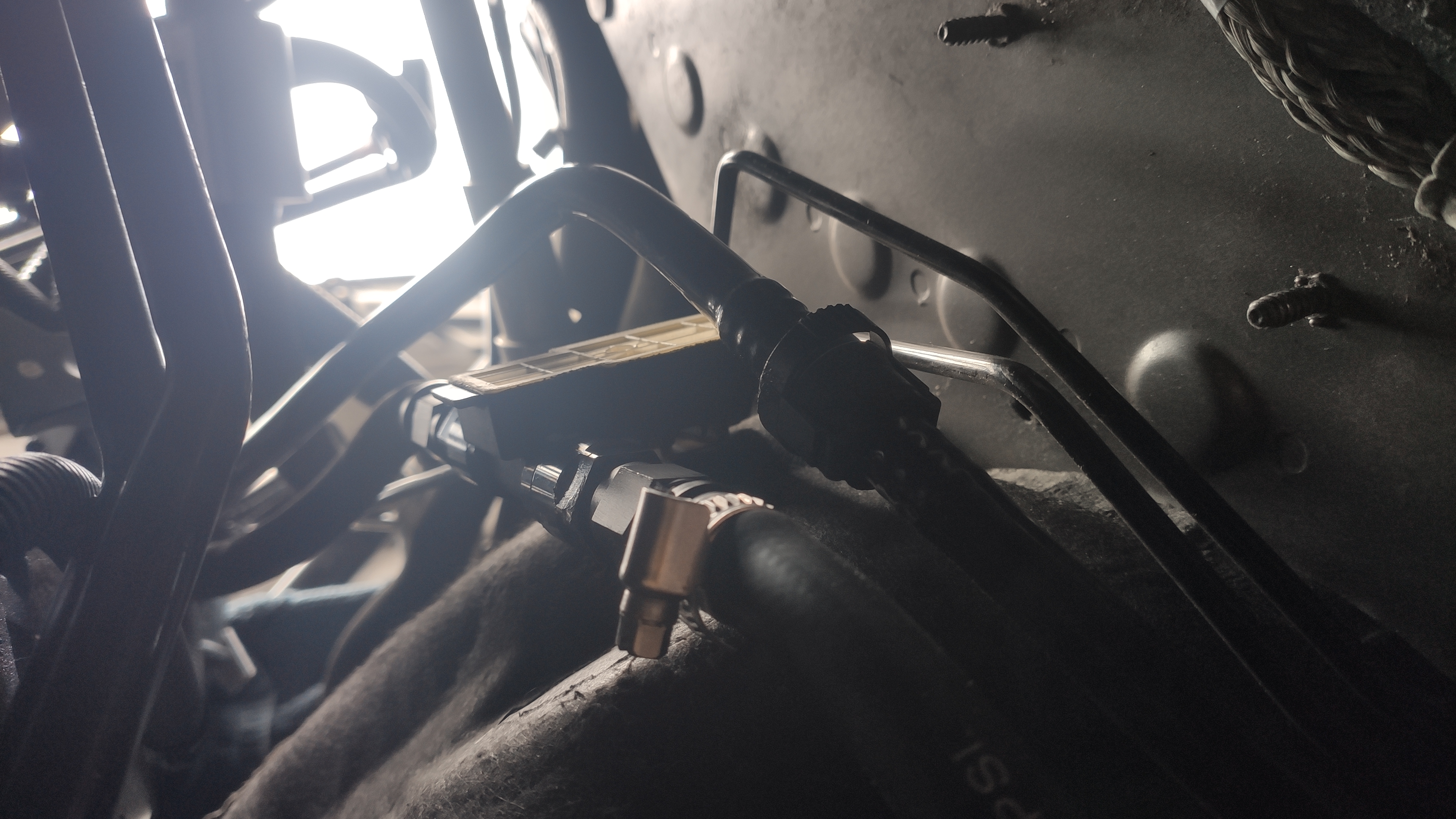

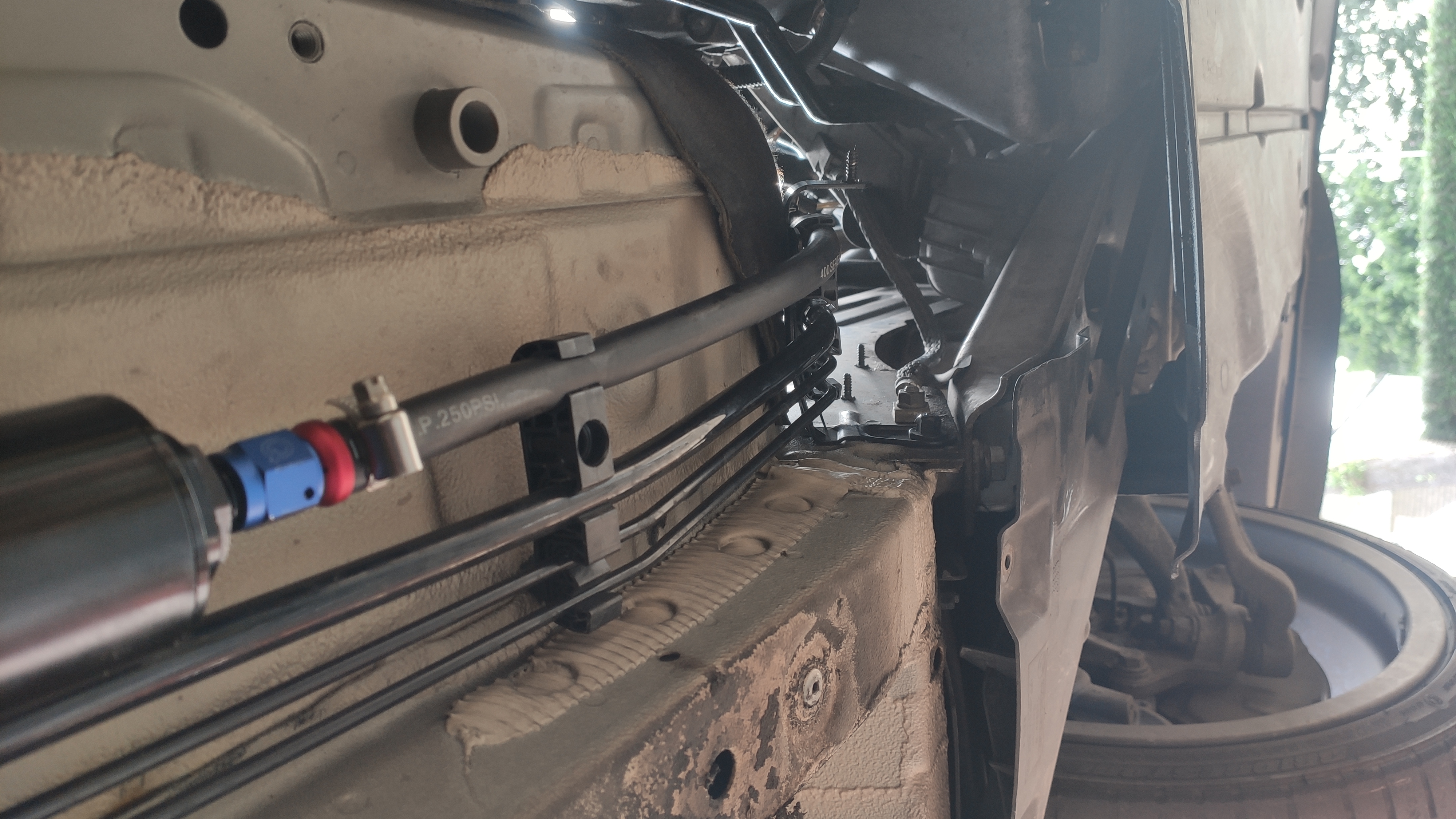

Well you already have a huge filter in t he tank, didn't see the need for it.
I run an external one in my 1m and after two years its still like new
Its a choice

It's not a choice, it's a requirement like Jern54 stated. The filter in the tank is not of the same quality/size (micron) as the filter in the hpfp. Particles can still get past that and clog up your injectors. It wasn't much but there was deff some stuff in the hpfp filter when i took it out.
Best idea is to run a a 10 micron filter like Spool offers as it's plug and play. If you also have an ethanol sensor or want to install one later on, i suggest you don't buy that kit but build your own custom fuel line all the way from the tank with a bigger diameter hose and buy a seperate 10micron filter to place in-line.
This is a nice and proper way of doing things and a good insurance policy. I may go this route in the future. Thanks.
