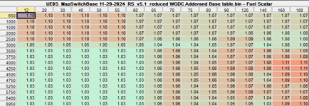

@That4chanhackerguy thanks for the feedback. What do you mean by Load Target up and out of the way? Boost ceiling is 1.5bar, is that not high enough? Do you recommend any3 bar map sensor in particular? Would this adapter do the trick with stock sensor or is a different sensor needed?
On fuel scalar, adding 3% to load 70 / rpm 3500 and up?
new fuel scalar:
