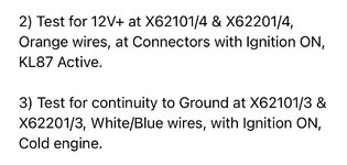

Thank you for answering, I am very grateful, I checked the power supply and ground, according to this test. Power supply from fuse f38 comes 12v, but Ground is broken (1) on the multimeter. I didn't even know that there were fuses in the ECU unit, everyone writes that I have it in the glove compartment, it is intact and 12V power when the ignition is on comes to the heating of the o2 sensors, but there is no grounding on the second wire of the lambda heating

Did this start with a code for oxygen sensor heater circuit? Curious what focused you on the ground side of the heater. I found this detailed diagnosis plan online (so many words!) and believe this is what you are looking for. Good luck and let us know what you find.
